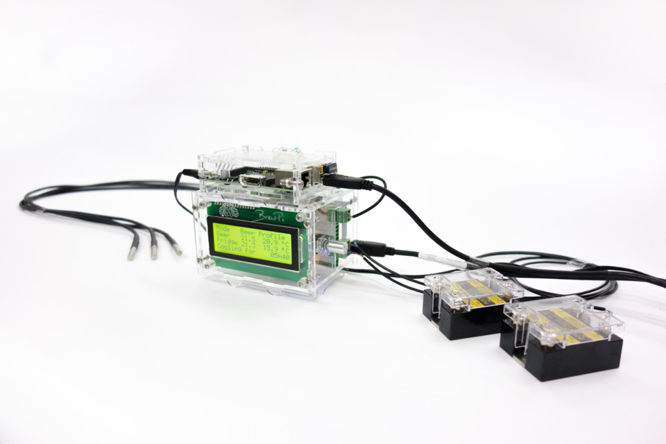

I see this image here from BrewPi.com, but that looks slightly different than what is available for purchase in the store:
http://www.brewpi.com/wp-content/uploads/2014/01/BrewPi-Case-2.0-with-sensors-and-actuators.jpg
That being said, what exactly do I need in terms of hardware?
How are the items in the photo different than what I need to get started?
I understand there’s more to it than just hardware, but it is the start :blush:

The pictures are showing the older Arduino model, where the team have now moved to the new the spark platform to monitor the sensors and control the SSR’s.
The Pi still remains in place to provide you with the GUI to monitor and control the Spark.

To summarize, the older Adruino shield has been replaced by the Spark. The photo displayed on brewpi.com contains the older Adruino shield which is no longer being sold.
