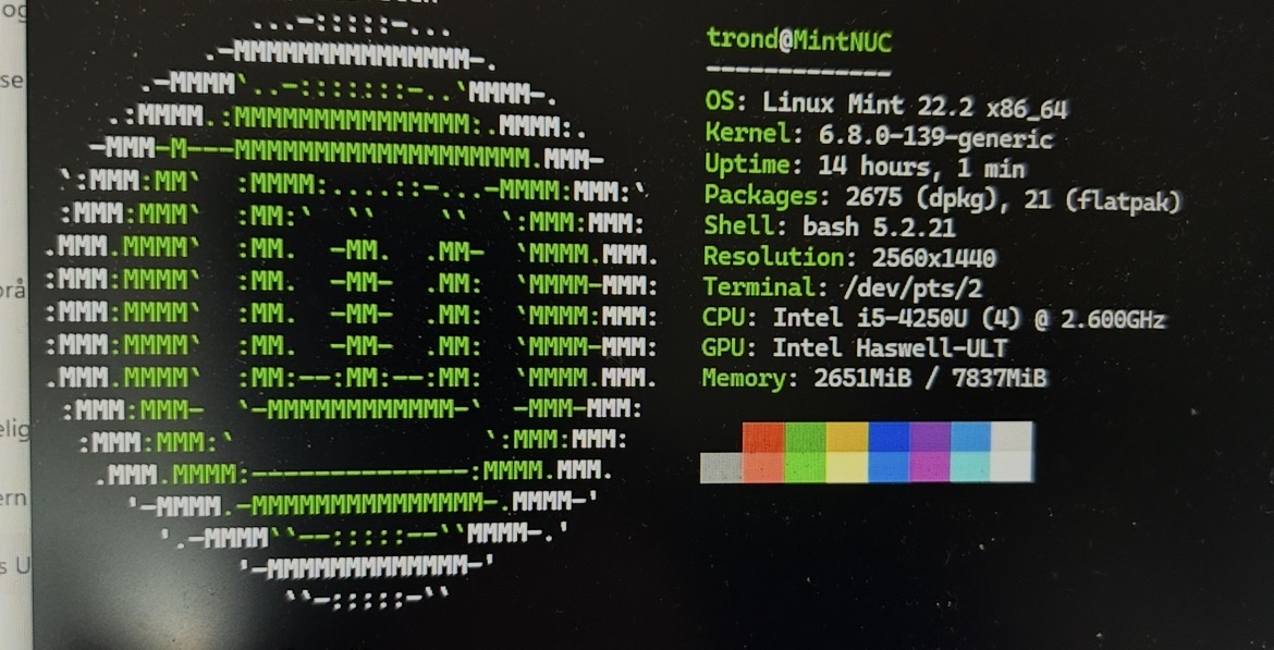

Python is version 3.12.3. Also noticed Mint wasn’t updated to latest version. I was on 22.2 and latest was 22.3. Upgraded to latest but no difference.
