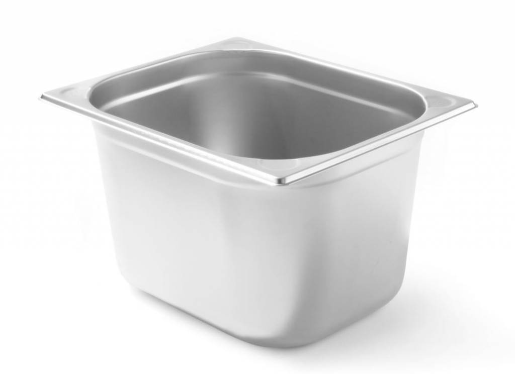

I had the following setup in a freezer at -20 celsius and it was by far not powerfull enough to get my 80L conical below +20 Celsius. Not even mounting a fan helped a lot:
I am now using flow through chillers which are normaly used for cooling beer on tabs:
The power of the freezer should be plenty, it is mainly about increasing the efficiency between freezer air and glycol.
I hope my stainless container is better at conducting heat.
If it is not sufficient, I think I’ll sandwhich 2 CPU cooler around the lid, similar the the photo below. Wall in place of the peltier, no fan on the glycol side. Note: I don’t recommend peltier.
