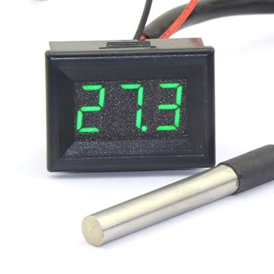

Something like this?
or something like this ?
Thanks for both suggestions @purpleogre and @rlightner . For an electronic solution, I think both of those ideas will do the trick. I can cut the existing temp sensors off, crimp a RJ12 connector and join the threaded Onewire sensor that I ordered with a regular phone line coupler.
