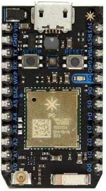

So I was building a panel to house all the components for my fermentation chamber, and I was just about done making all the connections when it happened. The USB port on the brewpi broke off! I took it apart to see if I can solder it back together but I believe there is a part missing. See attached pictures. Is there a way I can fix this with the parts I have here, because I don’t see anything else laying around. Please don’t tell me I need to buy a new unit…
That looks like the USB port. The Spark also has a 12V power port (round plug) that can be used as a backup.
You’ll need the USB port for updates, but @Elco will have to weigh in on how to get that fixed.
Is this the correct Photon for my BrewPi? If so, Ill just buy this. Would I need to do any programming, or setting it up, or would it just work as soon as I plug it in?
I ended up just buying the photon spark and pretty sure its the same one.
