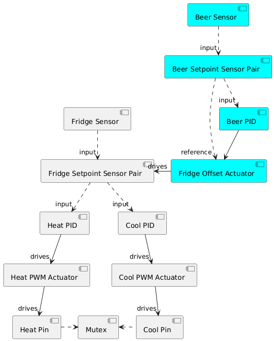

As preview of the control chains documentation: this is the full setup if youâre using the Beer temperature mode. (Setpoint Profile not included)
You can compare this with the block relations diagram in your Spark service page.
Another thing to check is which actuators / PIDs are currently enabled. You can switch between Fridge const mode and Beer const mode by enabling or disabling the Fridge Offset Actuator.
The setpoint values are also editable by clicking the pencil icons in the PID widget.
@Bob_Steers, my blocks donât look like that at all. Here is what my system shows, after using the âClassic Brewpiâ setup.
The input arrows point the other way, but otherwise these diagrams show the same thing.
The right-most four blocks in your relations diagram are rendered in cyan in my diagram.
The two blocks in the middle in your diagram (Ferment Fridge Setting, Ferment Fridge Sensor) are placed at the top left in mine.
To reduce complexity, you could disable Ferment Fridge Offset, and trace the Ferment Heat PID and Ferment Cool PID control chains. Both take input from the Ferment Fridge Setting, but one drives the heating element, the other the cooling.
In your graph, you may want to track the Ferment Fridge Setting setting and value, and the cool/heat PWM setting. This will tell you desired temperature, actual temperature, and how much itâs busy trying to heat/cool.
